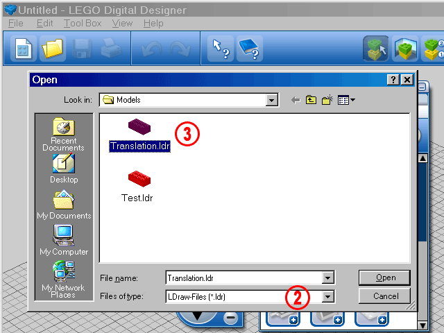

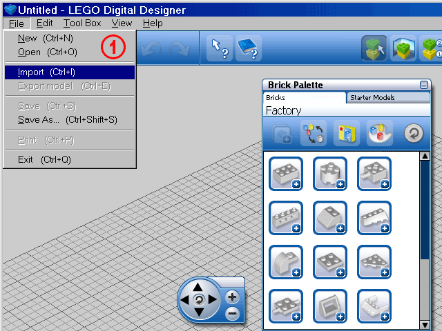

1. Select the File menu and then the Import (Ctrl+I) tab (File > Import (Ctrl+I).
2. In the popping up dialog you first have to select Ldraw-Files (*.ldr) from the Files of type: drop-down box. Otherwise the dialog will show only its default LXF-Files (*.lxf).
3. You can now read LDraw files (but not MPD files). After hitting the Open button it should load your LDraw-Model although there are likely to be numerous mistakes due to oversensitivity of the LDD collision detection or not supported colors.

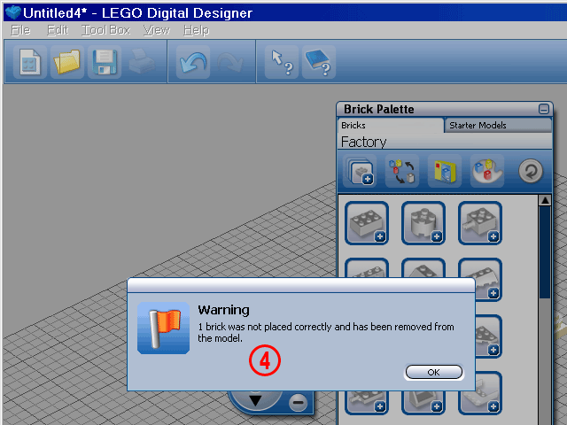

4. For the event you get this type of warning you should check the following:
  • Did you use parts not supported by LDD? The pallette of the supported LDD parts can be found at the LEGO Digital Designer homepage.
  • Contains your model parts in not supported colors? LDD's color pallette is in some ways limited by the bricks you can purchased through LEGO Factory. Therefore you can for example use a Brick 1 x 2 in all the colors below, but the LEGO Digital Designer will refuse to load an orange 1 x 2:
  • The part will not load because its translations hasn't been added to the ldraw.xml file yet or the internal LDD part number has changed. Please contact the LDraw Team if the part in question comes in the right color and is supported by both system but gives out an error. We will do our best to add the part for the next release.

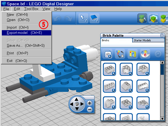

5. Select File > Export model (Ctrl+E) from the menu bar but don't forget to save your model first in LDD's own file format .lxf.

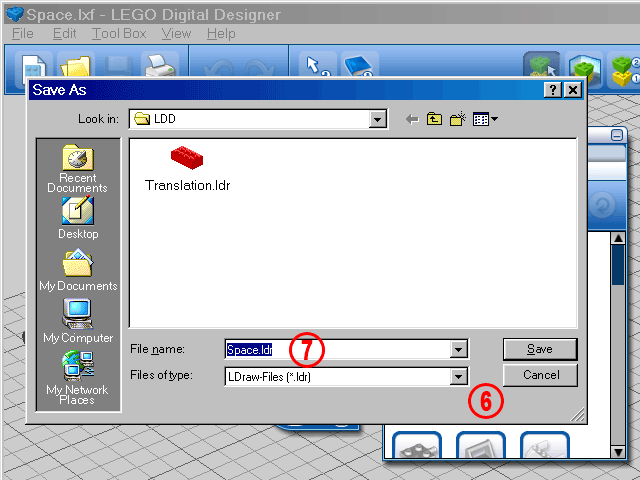

6. In the popping up dialog first select Ldraw-Files (*.ldr) from the Files of type: in the drop-down box. Additionally you might select the .lxfml file format which is a human readable version of the binary .lxf file and gives some very interesting clues about the part numbers used in LDD.
7. In the File name: drop-down box the LEGO Digital Designer proposes the name you saved the model with even after you have changed the file type. In case you don't change the file extension to .ldr - LDraw's official extension for models - the LEGO Digital Designer will ask you if you wanna substitute the already existing file and re-save your model in .lxf once you agreed to do so. It is therefore crucial that you delete the .lxf extension. Additionally you might type in the .ldr or change the file name to something completely different. After hitting the Save button will be exported to the selected folder although there are likely to be numerous mistakes.

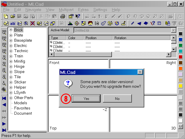

8. Loading the file in MLCad you might get the warning above due to different part numbers in the LDD and LDraw library. Hit Yes and MLCad will upgrade your file. If there are still missing parts there are several reasons for:
  • The part used in LDD hasn't been certified yet and is therefore not part of the official library. Downloading the package containing all unofficial parts might solves the problem but be aware that those parts have to be treated with much care and should not be stored together with official LDraw parts. However there are tutorials which explain how to include these unofficial parts in programs like MLCad.
  • The part hasn't been authored as LDraw file yet. Though LDraw.org now gets parts from the LEGO Universe Team some files still need to be cleaned for the certification process at the LDraw Parts Tracker while others are still in the queue.
  • The part can be found in the official Library but it's translation is missing in the ldraw.xml file. Please contact the LDraw Team and tell them when you encounter such parts. We will do our best to add the part for the next release of the ldraw.xml. Let them also know if you find parts with wrong rotations or origin points.
